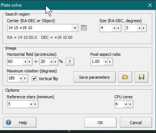

But plate solving nearly never works. I've been banging my head against this for months. I took the following picture of the field near Arcturus (which is in the upper left corner) and plate solve fails: My plate solve parameters are: If I set the horizontal field to 60 minutes +- 50% it fails. I've tried this with and without the vertical flip. This is with a C8 and F6.3 focal reducer so the field of view is around 60'.

AA needs a hint at where the scope is pointing. Click on the small icon next to the search region window to load the Ra and Dec from the image.

Which camera are you using? If you click on the '?' button beside the horizontal field info, it will provide a calculator to set the estimated field width. Is the mount being controlled by AA8 via ASCOM?JackG wrote: ↑06 May 2022, 02:48Re: AA8 SP1:

The resolution came when having the horizontal field well defined with just a few % (<10%) variation allowed. 20% or even 50% as I can see in your screen shots has been way too large for me.
Therefor, the calculation of the horizontal field is crucial. And then Reduce the variation allowed to well below 10%!

Hi, a tolerance of +- 50% with only 5 stars may cause false positives. I suggest to reset the tolerance to the default value of +- 20%.On the same image if I give the center search region of 12 +46 (note that M51 is really at 13 30 +47 12) it also solves "successfully" (no error message).
Actually after you measured the actual field of view, for example with the Statistics window, enter the exact value of the field and reduce the tolerance to +- 2% or +-5%, unless you are using a zoom lens.

Thanks, everyone. I'm getting better solutions on photos from days ago using your suggestions, especially narrowing the +/- tolerance. Rain and clouds for the next few days but I'm looking forward to trying it with the telescope again.
