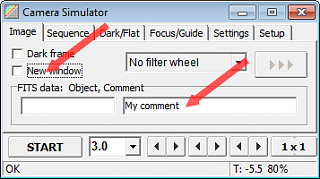

OK. Meanwhile a bug was discovered in Camera Control 6.2 beta:
the Option "Comment" causes problems if "New window" is disabled (also in Sequences).
The comment will be queued to one of the last download, growing the FITS header. After 100+ images the header will become so long that saved images (usually from Sequences) won't be reopened by Astroart (but you may still be able to open them from other software).
Current Workaround: don't use "Comment" if you disable "New window", especially in Sequences.
