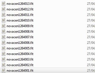

Hi all,
Perhaps an old question, but is there a way to avoid the leading zero's in the file nrs when making a sequence of images?
This because I use Isis which doesn't work with leading zero's....
Regards Arnold

Hi Ken,
I am back to using Isis...
Isis expects a file name like flat-1 and not flat-001, I can use flat-00 but the process will stop at 9 images, flat-010 will not be recognized....
Regards Arnold
Regards Arnold

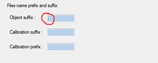

Hi Arnold, I use Bulk Rename Utility, a free file renaming software:
http://www.bulkrenameutility.co.uk/Main_Intro.php
It just renames, does not produce duplicates like ISIS tool. Converting sequential numbers is very quick (I spend only a few seconds before starting the ISIS session).
To convert 001, 002,... 010... sequence into ISIS numbering system, use the follow option:
It is important to order files by name before select them for renaming.
and ISIS, in General tab, requires a dash into Object suffix field, otherwise it not browse correctly the images in tab 1. For the present example ISIS generic name is "pi_aqr-".
If you do not use any separator character between the name and the sequential number (Ken's names, from what I see), the re-numbering is equally valid.
Let me know if something is not clear.
Best wishes for a happy new year to everyone!
Paolo
