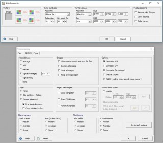

The reason I ask, is also, that I am very much in doubt if I am using correct settings in AstroArt 6, when making image sequences. What a shame if I have wrong settings, and all images are ruined !!! ???
I am using the following settings: When pre processing (stack), I use the following settings: My camera is an unmodded Canon 1000D. The CCD cell bayer mask is:
RG
GB
as far as I can find out.

the images downloaded from the camera are saved always as grayscale 16 bit FITS, and they are 100% identical to the CR2s.
1) The "RAW Images" options of Preferences do not apply, they ares used only for opening CR2s.
2) The "Demosaic" option does not apply too, it's used only in the command "RGB Demosaic" and in "Preprocessing".
The options seem correct, but before using them in Preprocessing you should verify them (once in a while) performing a RGB demosaic by hand, just opening a "raw" FITS file downloaded from the camera, then menu Color / RGB Demosaic.

By the way, as a general rule, you should disable the option "DCRAW demosaic on load", so that you can see the original RAW images of your test images (the ones taken without a software).

Looking again at your screenshots, I can see a problem: enabling both "DCRAW demosaic on load" in Preprocessing and "RGB demosaic" in Preprocessing is equivalent to apply the demosaic two times. Astroart will ignore the second one, but those options should not be set anyway. I suggest to disable the first one. If you convert on load, then it's impossible to correct dark frames and/or hot pixels.
