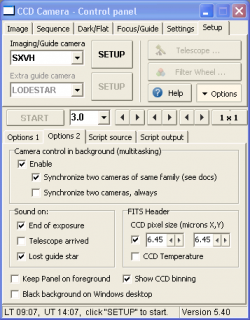

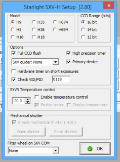

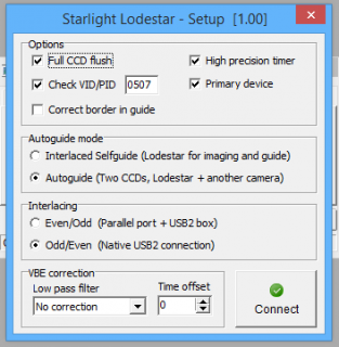

After a clean reboot both devices were present on the usb device list. I used USBDeview to verify this.
At first I had trouble with Astroart not recognizing the connected cameras until I tweaked the parameters for each until both were recognized and was able to take exposures with both cameras without a problem.
Here are my settings:
I rebooted the laptop 3 times and after each restart I went into AA and made sure both camera were present and was able to take exposures.
