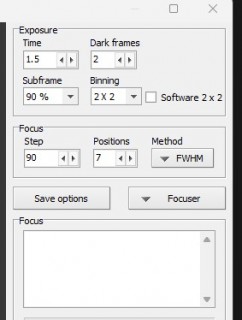

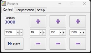

Hi Joe, I also use a Robo-focus. I'll tell you how I set mine up, that should get you close.
If you take an image and you see fairly in focus stars just use the settings you see in the screen shot. If you are out of focus use the manual focus buttons to get close. I have an SCT with the focus motor attached to the focus knob, a MoonLite focuser on a ES102 Ed triplet and a stock focuser on an AT 72 Ed II. These settings work well on all 3 scopes.

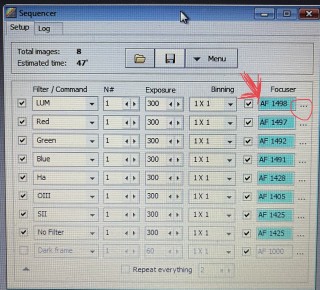

I figured out what I was looking for. In the sequence window, off to the far right, I entered the initial focus position for each filter and selected focus from this position option (click on the “…” to the right on the sequence window and the options pop up) which puts an “AF” in front of the step count. When the filter changes the Focuser travels to that initial position and starts a focus run. I added a picture below.
I ran a couple simulator sequences using the above method and it seems to work just fine. Unfortunately it looks like rain this weekend so I won’t be able to test this under the stars. When I do so I’ll report back.
