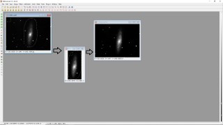

it344x wrote:
13 May 2021, 10:54
bumping this thread as it is very, very useful.
If there is a way to create a mask and use the histogram stretch ONLY on the mask section that would enhance this ability even more.
For example, I want to select a galaxy, invert the mask selection and change the rest of the image leaving the galaxy alone, but histogram stretch changes the entire image.
Hi - this can be done -
Mask the area you want to stretch, copy the selected area to a new image, stretch as required, then register the images and merge back to the original using max or blending as you wish. Here is an eg using one of the sample images.
