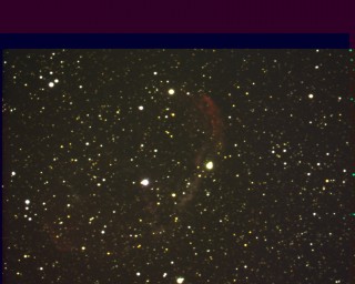

Very well sir: Here is one recent effort with the Crescent Nebula. It's about 7 subs ea. @ 210 sec. RGB only if I recall correctly. I am enjoying the challenges very much, but feel like doing a copy of an internet picture would be cheating..I look forward to getting better at color development...
I am eager to maximize AA..
thx again
Charles

Crescent nebula needs quite long exposure.
Was this 7 x 210s R, 7 x 210s G, 7 x 210 B ?
What scope & camera ?

Hi there,
Yes only RGB for this frame. Using an 8" Edge w/.7 reducer. I have a very good camera, Atik One 9.0. Also, these subs were 1x1 binning. I am beginning to believe that really good color must come from more than 7 or eight RGB's, even if those are binned. I have achieved fairly good collection of color through my refractor with the same game plan for exposures, but I am getting impatient with my several results at this point with my SCT - that is, achieving color in the stars. I will attempt to color balance my exposures with the white star test tonight...but I seek the knowledge on just how much data/and number of exposures will it take for good RGB collection.
thx for the assist..
Charles

Einari,
Correction...I meant to say these RGB subs are all 2x2 binning.
thx
Charles

The LRGB "stealing" was just a tutorial to show how LRGB works
In the image the blu channel is very weak, I think that it can be boosted during the trichromy since your image is still noise free.
25 minutes for R, G and B may not be optimal as S/N ratio, this is why I suggested to post the separate channels. Depending the sensitivity of your CCD and the filters, something like 20 / 25 / 30 may be better.
