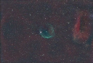

The flat field correction doesn't seem to be correcting the image for my ASI294MC Pro camera in preprocessing. So, I ran preprocessing without the flat field and manually used divide with my flat field and the results were much better. Not sure why it is not working in preprocessing. Images are attached. I had to reduce image size to send.
Image with Flat in Preprocessing
Image without Flat in Preprocessing
Color Flat
Image after Divide was applied to Image without Flat

Hi, the image "without flat processing" shows a strong left-to-right gradient, so that flat field cannot correct the image in any case. Maybe there was a strong light pollution or dew.
Here is a quick processing on that JPEG with Remove Gradient Adaptive 25, after having masked the nebulas:
(the mask does not need to be precise, it's only a suggestion for the algorithm, all the image will be processed anyway).

I have also removed the gradient with points in the image after I divide the image manually with the flat. My question is why doesn't preprocessing apply the flat so I don't have to do it manually.

To solve it would be needed to see the original images. I think that Preprocessing is actually applying the flat, but the correction is partial because the images also have an extra gradient caused by light pollution.

I'm not trying to correct light pollution with the flat. How is the flat correction applied during preprocessing? When I manually apply the flat correction it does correct the image. I just don't know why it doesn't work in preprocessing.

Hi, in preprocessing, a GRGB RAW flat field (so grayscale) is used as luminance (unless it's already a color master flat field), so it cannot correct chroma variations. The menu command "Image / Divide" instead divides each R/G/B planes separately.
To solve, prepare a color master flat field (averaging several flats, with darks) using the "Images" box, with the usual option "Demosaic RGB". This master flat can then be used as a color flat field and will correct chroma variations.
An option for automatic debayering of GRGB RAW flat fields is interesting by the way, it will be added to the next SP in february. If you like to have the pre-release, just write me by PM or email.
