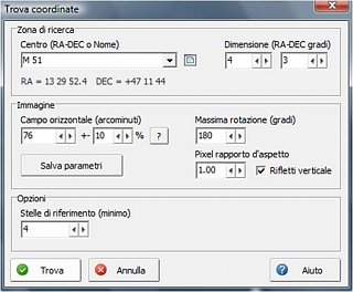

I am successful in 2 seconds with these settings
