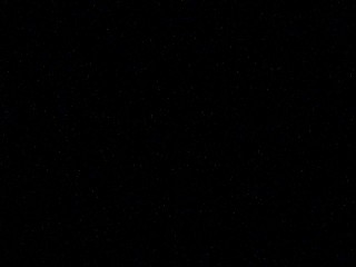

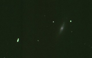

Dear Fabio,
you are kind I attached 2 light frames (with the maximum offset between them), a dark frame and the screenshot of the result of the manual align (you can see the little arcs in the lower right corner due to field rotation).
It's most likely my fault as I am still learning the tricks of processing deepsky images The source images may be wrong too. There are 18 light frames, the offset between them varies in distance and direction too. All of the auto align methods give ghost images (I left all options on the default).

yes, the "Two stars" method will work (increase the Radius to 100), but not perfectly, because the images also have a difference in scale. Maybe they were taken with a zoom lens which moved? cause the temperature?
So, the correct alignment should be done with "Star pattern" but it's not possible on the JPEGs, there are too many defects. If you like send me by email the original RAW FITS image #01 and #34. I think that with some hot pixel correction inside the RGB Demosaic the "Star pattern" could detect the required stars.
